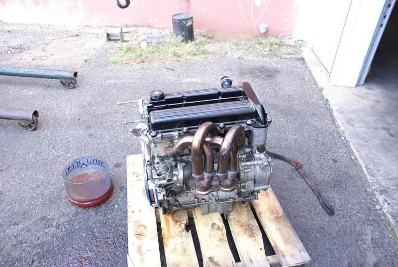

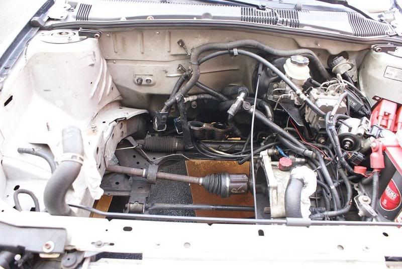

where'd my engine go?
oh.. there it is
let's see what we have here...
hmm that doesn't look right...
how come this isn't in place?

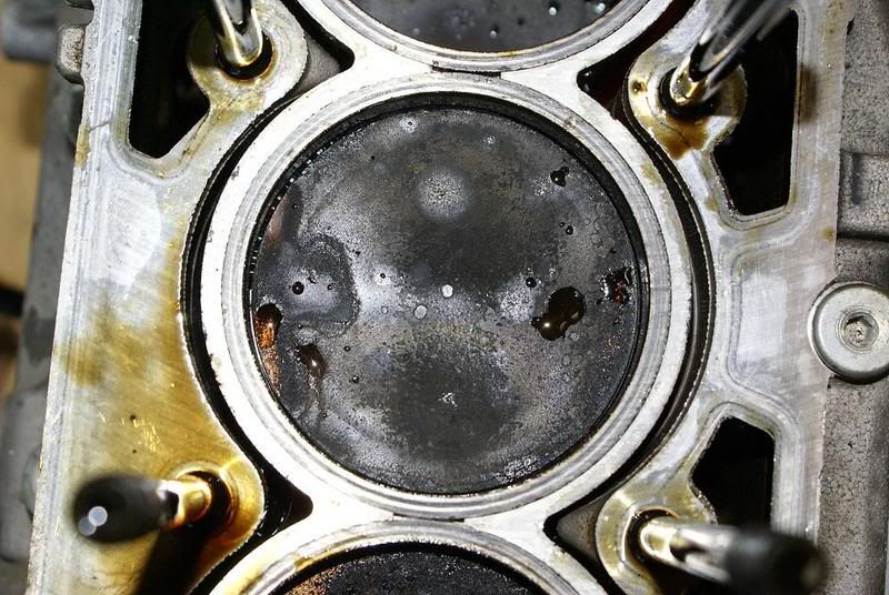

normal cylinder
cracked ringland

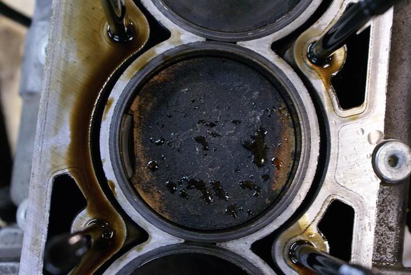

normal cylinder (flash on)
cracked ringland (flash on)

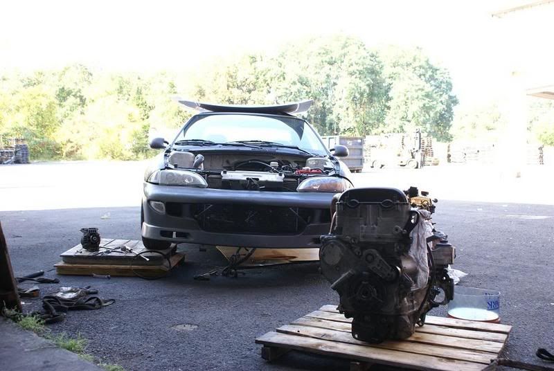

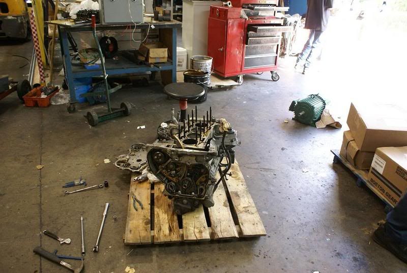

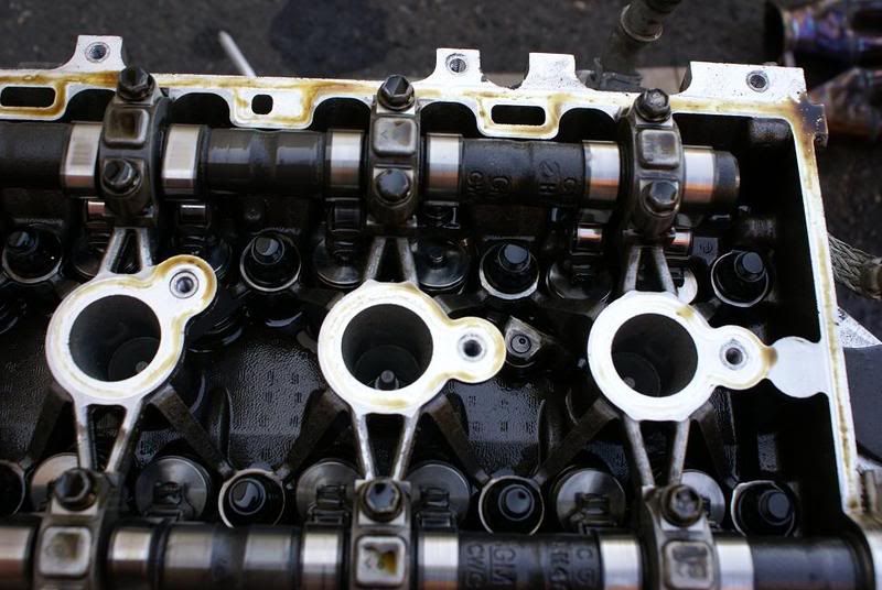

engine chillin in the shop
jay messin around with the head
cams removed, valves inspected. the head is ok (might have leaky valve seals but otherwise checks out)
so here's the synopsis:
cracked ringland happened during a track run on a lean afr at high rpm. detonation cracked off a piece of the piston and smashed the plug closed. plug was physically reopened with a screwdriver and the engine ran ok.
about a month later, (3 days ago) the engine started sounding like a WRX. checked the plugs and didn't find any smashed.. so I pulled the engine. Found the broken lash adjuster.
I'd imagine repeated high rpm abuse took its toll on the factory lash adjusters and this one simply failed. The strange thing is, its in the same cylinder that had the cracked ringland. I'm wondering if the two are related..
regardless, all my valves are spotless, no bends, no dings or scratches. just excessive carbon buildup. and possible leaking valve stem seals.
interesting fact:
all the pistons have a small depression in the same area as the missing ringland in the #3 piston. I'm wondering if that is some kind of hotspot in the combustion chamber due to injector spray pattern, or cylinder fill or something.

nope the valvetrain was upgraded.. the only stock components were the finger followers and the lash adjusters
Re: accident analysis: all motor ecotec failure
Sunday, October 07, 2007 6:17 PM
You are definitely getting a lean burn along the ring lands, on both the intake and exhaust sides of the chamber. How do the combustion chamber on the heads look, compared to the pistons? Hard to tell from the pics of the head on the work bench, but it looks like the chambers are round. Do they match the cylinder bores? Whats the compression height between the piston top at TDC and the head? Could it be improper quench? You should have between .035" and .040" ideally. It almost looks like the ring lands are getting washed down, i.e., the fuel is collecting at the edge. That would indicate the lack of swirl in the port runners. (Did those who had the boosted motors, have stock or ported heads? Did they have the same burn/wash patterns? If so this could indicate a design problem in the chamber flow pattern, causing the the fuel to collect up in the stagnant areas of the chamber.
As for the lash adjusters, are there any aftermarket/heavy duty adjusters you could use to prevent the adjuster failures in the future?
Just some food for thought on the failure analysis, hope it helps.

DaFlyinSkwirl (PJ) - BPU++ wrote:nope the valvetrain was upgraded.. the only stock components were the finger followers and the lash adjusters
Just curious if there are any aftermarket lash adjusters or bigger ones or what is done differently on the ecotec drag car regarding the lash adjusters. I am not that familar with the engine but if they are easy to replace maybe you could just replace them before you think they might fail if you can't find better ones.
I wonder if the valve may have closed on the broken peice of ringland on the way out and the lash adjuster was weaker than the broken peice of ringland causing it to break. I do not know that engine well so I could be way off. Just a thought since it seems an odd coincidence it happen to the same cylinder.

going with what MadJack said, and the fuel puddling issue in all 4 cylinders, it sounds as if your lean issue was unavoidable. possibly an incomplete burn? and the "puddle" finally ignited because of a hot spot from inefficient exhaust flow? is Patriot aware of your issue?
there's too many variables to easily narrow it down, but I doubt the patriot head is at blame.
jay and I are beginning to think that my injector spray pattern may be the culprit... but the overall problem is that in 2003 they changed the design of ecotec pistons for better emissions... by moving the topmost ring closer to the top of the piston... weakening the top ringland
also, I just got off the phone with Jesel...
