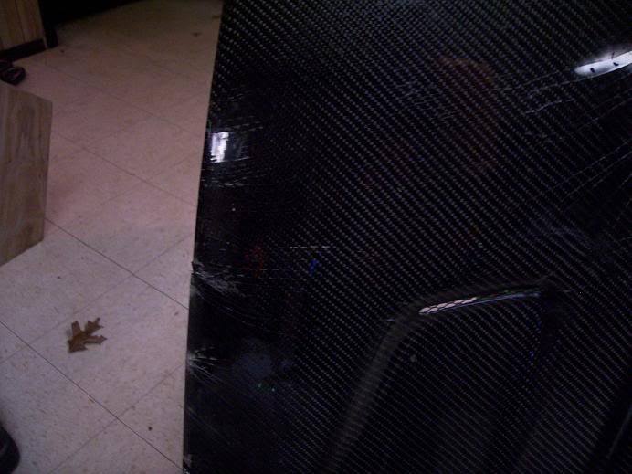

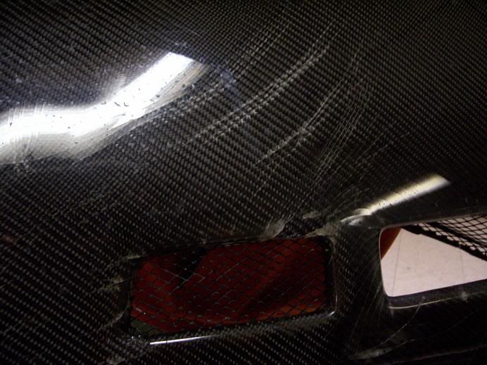

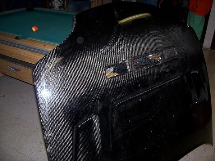

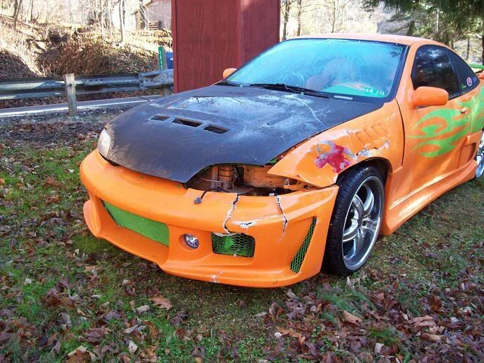

Thanks guys, I dont think it can be fixed. I hope it can, Here is some pics of the hood and of the car.
here is a pic of the car.

Ouch, even messed up your z3 fenders and front clip; @!#$ty man, really @!#$ty.
Good luck, hopefully you can fix her up.....

well since the weave is fine, and its just the epoxy resin that is cracked off...you can technically fix it still.
if you use some kleer koat resin from uscomposites, you can lay on the clear resin. Once it is cured, use some 300 grit sand paper and sand the resin smooth. by sanding the hood in that whole area you will level out the clear resin. then get the whole hood re-cleared from a shop.
I dont really see why that wouldn't work.
if you don't go that route, some fiberglass sanding, and painting in that area will be required.
listen to the man.....thats exactly how you fix your hood. $30 for the resin and sand paper and then whatever it costs to reclear the hood from a shop. since youre doing all the prep work, you should be able to get it shot for less than $50, around here anyway.
