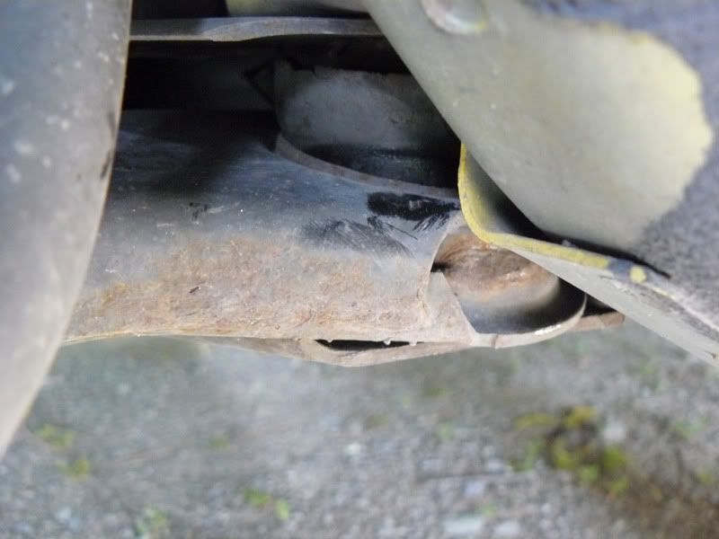

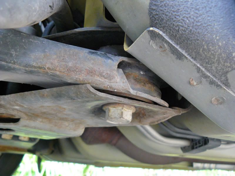

CHECK THE LOWER CONTROL ARM BUSHINGS AT THE REAR OF THE ARM. THE RUBBER SEPARATES AND THE ARM BANGS AGAINST THE SUBFRAME. MAKING AN AWFUL THUD BANG CRUNCH NOISE. LET ME KNOW WHAT U FIND
