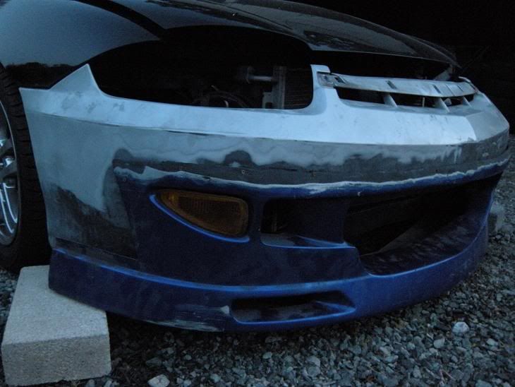

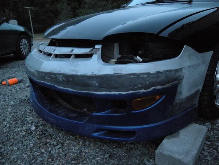

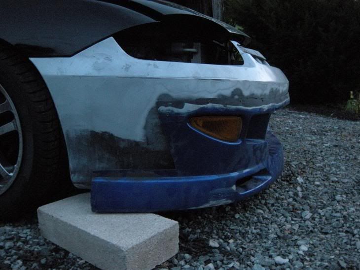

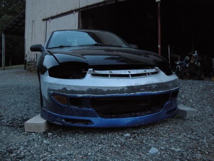

Ok, got some work done today!!
After some mocking up and aligning things, I didn't like how the LSS lip was going to look with the import fighter, so I decided to go back to plan A, and just do the import fighter fitted to a 03 bumper. (sorry Mike and Azn cav!)
I made the needed cut out in the 03 bumper, then mounted it to the car so I could start reshaping the import fighter around it. I may have to modify the bottom of the crush guard a bit to accomodate the center grill opening of the import fighter..I could bend down the inner lip of the grill cut out, but i think it will look cleaner to just shave the very bottom of the crush guard so everything sits flush.
The IF has a really sharp curve above the grill areas that slopes towards the headlights, where as the 03+ has a more flat ridge, so before I put the IF on the car, I heated the top edge and started pulling the curve out to a flat surface similar to the 03. After that, I slid the IF into/over the 03 and began heating and bending it into place, then chilling it with water to "shock" it into taking the new shape. I had a chance to shape most of the curve under the headlights, and started around the corner lights, though they still have much more heating and bending to bring them to the proper shape.
The driver side of the import fighter needs to be pulled up a little higher, as it is sitting a little crooked right now.
The main object right now was to get the seaming areas of the two bumpers into the same shape, then I'm going to taper down the edges of the two parts before bonding them so they sit flush.
The far ends I cut off for now to give the bumper more flex while I bend it into shape (it was just too rigid the first time I tried shaping it, so I cut out the chunks from the side to take away some of the support). Once the bumper is shaped as needed, I will heat and bend those pieces separately, then epoxy them back in. As it looks now, I may have to heat/bend some plastic sheets to make the difference in the lip as it doesn't quite reach the wheel wells (didnt think it would)..i'll have to see after some more heating and bending, maybe the end of the lip will eventually reach the end, I do still have a decent sized curved on the sides that needs to be flattened out a bit more..

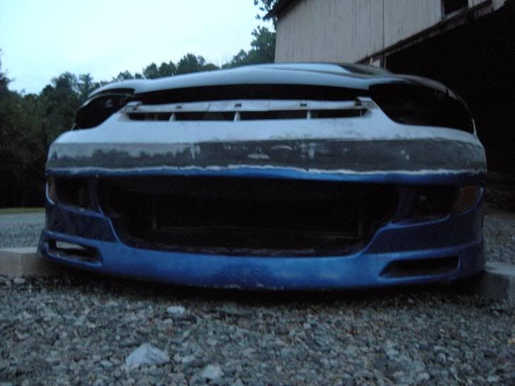

In the next pic, if you look at the tip of the nose above the center grill, you can see how the 03 has a gentle slope down, and the IF has a hard slope up, this is a spot where I still have a lot of heating and bending to do. I should have taken a pic of the two bumpers together before I started heating so you could see how far off the shapes are, but I forgot..oh well, I'm sure everyone has seen enough pics of the two different bumpers to get the idea.
That's where I'm at now, I have a lot more heating and shaping to do before it's ready to bond, but it's some progress!
C&C please!

i think its to low IMO
Re: 03+ Import Fighter Sexiness
Wednesday, August 11, 2010 6:40 PM
azncav wrote:i think its to low IMO
Yeah, I was debating moving it up a bit, but I want the the lip to line up with the GMX sides, and that's where it lines up...though I may still play around with it a bit.
Wednesday, August 11, 2010 6:52 PM
please make sure you keep the lip level to the group all the way around. no sloped like it is in the pictures.
Wednesday, August 11, 2010 7:14 PM
Ryan suddick wrote:please make sure you keep the lip level to the group all the way around. no sloped like it is in the pictures.
You should re-read the update bud...I pointed out that it is sitting crooked right now and has to be adjusted. Right now my concern is getting the shapes of the bonding locations to be the same.
