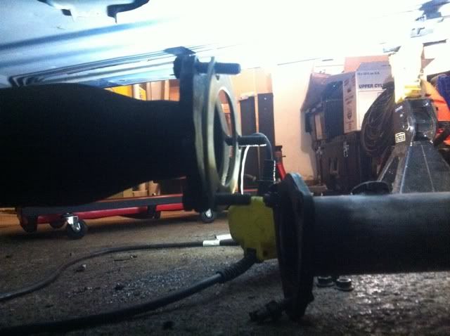

Here's what took me about an hour to drill and fit tonight....

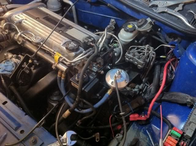

Not much, but progress. Exhaust is pretty much done, let see all that's left now is:
-Dipstick Bolt to 2.4 intake. (theres a spot that will take a nut behind it, but its tiny)
-Injector harness
-Torque down exhaust - narrow bands /w copper crap
-Run wide-band and fuel pressure sender wires.
-Boost gauge line.
-Put the charge pipes on.
-Fire her up!
I did pick up a g-reddy (sp?) EBC for like $10 its all in japaneese, so I'm gonna hold off on that for a while, but from what little English is on the box, it's pretty sick. Pics of my new goodies tomorrow.
I got the reusable 2.5" aluminum gaskets for the down pipe. The o2 housing to turbo is good ol Mr.Gasket.
-4AN m to f with a 1/8npt for the sender is in the mail also, should be here in a day or 2. Need to figure out where to mount a 3rd gauge. I'll be running glowshift boost and FP gauges, then an AEM wideband gauge. Unless this A/F glowshift gauge that my buddy gave me will work with the aem harness. Probally sticking with the aem gauge.
I can probally knock this all out in like 3 hours, I've just been so lazy haha.
