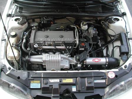

here's mine .. straight off the SC, cut out the hole a little bit wider where the intake drops through into the fender well. then band clamped some rubber pieces onto the intake to keep it from vibrating against anything
