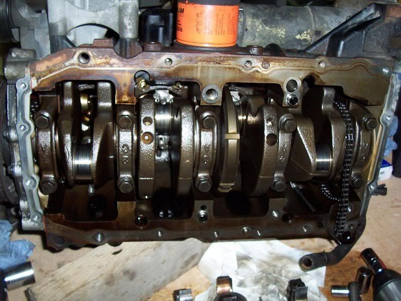

replacing the rod bearings IS EASY compared to taking the head off of the car. i've only done it like 3 times..... maybe i'm just better w/ the 2.4. yes, you have to drain coolant and oil, take off the coolant line that goes around the bottom of the engine, then take of the oil pan (which is just as easy to take off as the eco pan), then take off the oil pump, i understand there seems like alot to do, but this is MUCH easier than mr jarvis says. this may take two hours or less, at least for me. i think with the rod bearings being a major problems with the 2.4 its a great idea to check this out.
you will be able to tell a good rod bearing from a bad on, its very obvious.
but i do agree, let someone that has had a rod bearing problem listen to it.... we know what it sounds like

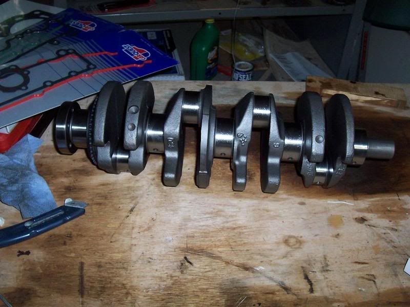

you can see here in this pic that the two left journals are scarred... i worked on one other engine that had a spun bearing the journal was actually ovalized if thats a word....

im real greatful for the help.......but i cant see the scaring that you are talking about on the two left journals
Re: wanting to turbo my LD9
Wednesday, August 20, 2008 5:58 PM
thats a brand new crank.... the scarring looks pretty obvious to me on the first pic i posted. maybe just cause i got used to seeing it. but u see how its just like lines that go all the way around journal, thats the scarring. its much better in person, and to be able to run ur fingernail over it helps too lol

ok cool now i can kinda see what you are talking about. do those come off? they look like part of the crank. would i have to get a whole new crank. and yes that writeup will be of some good use to me. didnt know how big of a problem this was and sorry to everybody for talking about this in the boost forum section

the journals are apart of the crank. that was the new crank that went into my engine. you can just replace the rod bearings and it would be ok for about 4 months, but it would just spin again (if your crank is in the condition my crank was in). i'm thinking if u get to them and replace them before they mess up the crank, then you might be ok. i'll find that write up and pm it to you.
