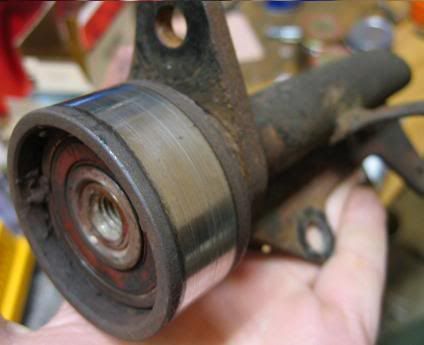

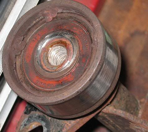

ok this is an odd one.....
I got my SC rebuild kit... and went to start rebuilding.... pulled the serp belt off and felt the pulley fearing how bad it would be..
to my suprize it was tight and smooth as anything.... i couldnt figure out how this bearing could be making all that horrible noise (for MONTHS now my SC has been making a horrible grinding/squeaking noise... very hit or miss.... mostly seems to get worse when humid. when warm and dry it was quiet, or quieter at least....
So i get thinking, as now i need to know what was making all the noise. tensioner pulley is fine, alternator is fine (better be it is only a few months old), and then i grab ahold of the static idler pulley... that thing was so loose i thought it was going to fall off in my hand... give it a bit of a spin, and sure enough...GRINDSCRAPESQUEAL...
My supercharger was fine all along... it was just that one damn idler pulley....
I was relieved to know my SC was safe and healthy.... But then i realized that this idler puller is not a stock part... this comes as part of the SC kit.... so that means i am not going to be able to get a replacement part from autozone or anything.....
It was an incredible paint to get off, but managed to remove it from the engine bay....
Most interestingly, upon closer inspection, i found the bearing itself to be in good shape.... but it appears that the whole unit is nothing more than a axle shaft, with a pressed on sealed bearing.... and some odd type of metal "sleeve" that slides over the bearing.
here it looks like the sleeve has come loose... (and currently look like it wasa bit too large to begin with.... ) and the snap ring that appears to have originally held it in place is missing.... and in its place are a few tiny tack welds.... looks like someone tried to weld the sleeve to the bearing, and did a poor job of it....
so.... I am curoius as to what this part is SUPPOSED to be like..... and i am curious as to where i might be able to find a replacement for it.
I think for the moment i MAY try to re-tack weld it, just to get the car running again.... and buy myself time to find the right parts....
I will attach a few photos in a few minutes here.
if anyone has a SC kit that hasnt been installed yet, if you could snap me some pics of this piece, that would help me out alot....
