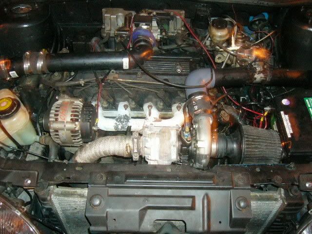

Ken- thanks for the pics. Seeing that nice turbo is really making my wheels turn and wanting to start ordering parts. Your turbo looks huge. everyone seems to be running different size turbos and impeller sizes. You guys have made some really impressive numbers on a stock bottome end. I'd like to get as much advise as I can from all of you. I've been reading up on searches but i'm still gonna have questions sooner or later. Ken- do you remember any part numbers or what parts specific you used? I have some sweet hook ups from distrubitors so if I could get part numbers or what part exactly were used I can start spending money right away. I dont really want to order a pre fabed kit since my way will save a ton of money. I'll be gone on vacation till sunday so if i dont respond thats why.

however here is pix of my setup... I like it but it spiked to 15 psi the other day so I think a ring went. big smoke everywhere...
I like it i hung with a turbo integra till some massive fuel issue i had. and I had the srt4 guys watching me because I had a jump on them till they hit 3rd...
