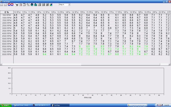

so whats your a/f ratio now? is that X Y axis you posted exactly how yours is now? after you did some tuning? just wondering, but why are some of the numbers in green?

The fuel map i posted is mine now with the tuning complete, the colors just represent how hard the fuel system is working i believe, it has 3 colors, black, green, red. I Noticed that lower fuel volumes its black and the more fuel you dump through the rpm ranges it changes to green then red. And a/f ratio is 12:1 across the board under boost. And the injectors in the hahn kit are 40lbs.

We played around on the dyno for about 2 hours trying to find the best setup we could. Its alot different then the hahn setup. With the machine work on the head my car would flow more air faster so when you'd first hit it, it would go lean fast then slowly come down. I think it would jump up to about 15.5:1 then drop down into the 12's. Thats where most of the changes where made, early in the rpm range, with the 16g turbo im seeing full boost at about 3200 rpms lol. Im not sure as to the power limit on the port fueler system, didnt hahn get like 404 hp out of their car? Not to sure. The port fueler system isnt to bad to install. Its got 4 clips for the injectors, i think one that goes into the ecu, one that goes into the downpipe to watch the a/f. And then a line to monitor boost. With the tuning software you can also record your dyno pulls with the port fueler system, so for the man on a budget you could street tune your car. It really shouldnt take more than maybe 2-21/2 hours to install. The only draw back is that i think im gonna have to pull my intake manifold off to change my oil filter. I was looking at it when we put it on, and well theres just no room there at all.

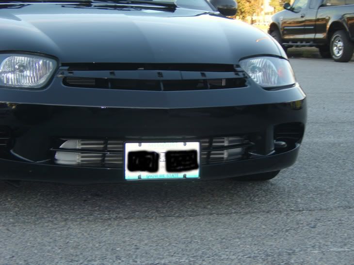

thats the manifold on my car
and thats the front mount
