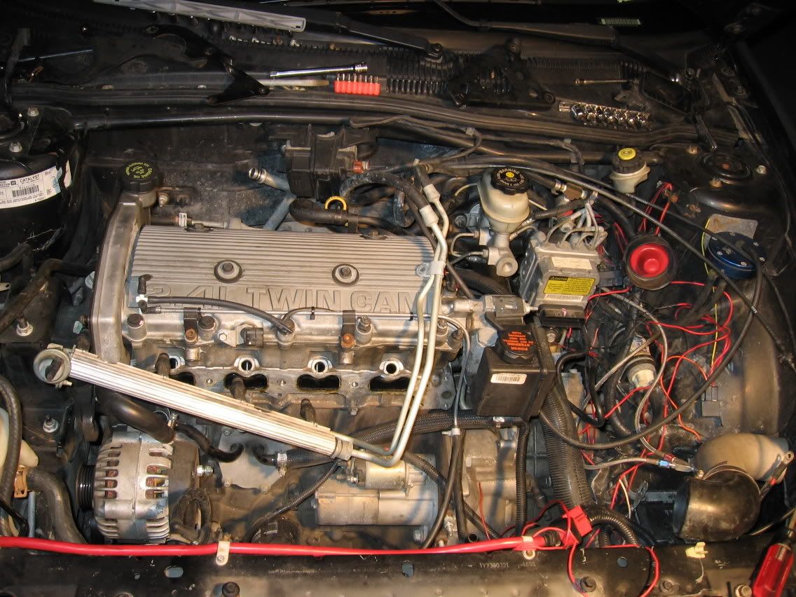

Next stage up and goin!
Now you see it...
Now you don't! Takin everything out that weighs, damn supercharger weighs a ton, gotta get rid of it, yeah right! Had to be able to get to other parts of the car and havin the runners tapped for direct port! wOOt! wOOt!
Missing anything? Am I gonna need that pulley delete? Probably, aren't I! Anyone know the gm part number for it?
There it is! Right where its supposed to be, off the car and not causin anymore weight!
What the hell is this thing, why does it have vacuum lines comin off it and what is that thing with the green top on it and where does it go? Anyone?
Notice anything else gone? Not just the supercharger and A/C?
Anything at all?
Heres a hint! Its the cause of alot of my aggrivation and an untapped source for weight reduction... well no, not really
Damn faulty wiring harness, blowin 2 ECU's on me! I kick you and I feel better!
Do I really need to keep the hood down? Damn, it, alright, its goin back on.... unless someone else has any better ideas, and no, I don't mean hood pins Jim!
Just a couple random pics of the wiring harness and supercharger before they meet the dumpster, STUPID PIECE OF SHOE! No... not really...
Seriously, tho, I need the part number for the pulley delete for the 2.4, also need to kno if anyone has any ideas about if I can latch the hood without using that huge brick of a thing, and think of a way I can put in lexan windows, still have the ability to remove them with gutted doors. I have an idea, but cant find the parts necessary, so I guess my idea is out the door. carbonfiber doors are a little out of my pricerange, thinking about the fiberglass doors tho, but not now. My wifey would kill me, she already thinks I am nuts!

That thing with the vacuum lines and green top is part of your emissions system, keep it in if you need to pass...
You should make an aluminum bracket to hold the hood latch, and rivet it to the stock mount and front bumper.
