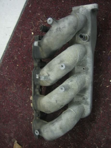

baught an HO manifold from the engine classifieds.. i wont say from who yet.. i got the package today and low an behold, its an LO manifold.. or from what i understand is.. ive had a couple by now, an it jus doesnt look right.. he swears its off a berreta gtz... heres the pics.. need your help guys, is this an LO or HO?
thanks..

Definately an LO

That's LO.
There's shouldn't be any 'hump' on the one side giving a size diff running across the entire base. (if that makes sense)
And you can't go by the screw on the back either.
I was sent a pic of an LI with the screw that's in all the HOs.
But the mani was LO.
There are pics all over in other posts.
Try to get it exchanged money back or something.

I just got my HO mani today.......If im not mistaken, isnt there a screw in plug on the backside of the manifold next to the P/N......thats how you can tell if it a HO or LO...?.....correct me if im wrong.....

Lo for sure.

PhilioZ24 wrote:I just got my HO mani today.......If im not mistaken, isnt there a screw in plug on the backside of the manifold next to the P/N......thats how you can tell if it a HO or LO...?.....correct me if im wrong.....
thats wat i thought..
yea hes bein a prick.. arguin with me that its an HO.. i dk, his name is Brent Dixon, has a bunch of mani's an tb's for sale.. oh well, waitin on another email from him

Ive been chatting with Brent.
And Philio, Ill try to find the email.
But he sent me a pic of a potential HO, with the 'screw plug' in the back...
BUT...
It IS an LO manifold.
And is the second one i've seen that's like that.
So you can just go by the screw.
I don't doubt he pulled it from a GTZ.
I'm trying to get a mani from him as well and he's been straight up with me.
But yeah try to get that HO

Hey I wanted to clear all this up, it was really just an F up on my part, the way I check if it is low or high output is by the 8th digit in the vin being an A and it was, but the manifold was already like half off on this beretta and I checked for the A and just pulled it and didnt really think about it, I pull alot of these so I must have just been out of it or something, it was a screw up on my part and I apologize and I am going to hunt down another for Marc.

another way to tell is when you look down on it like the first pic there should be only one vaccuum line to the left of temp sensor...i think...lol..i'd have to go look at mine but i'm pretty sure i'm right...

you cant really go by the VIN's any more
since the cars are getting old , alot of people will swap a any quad 4 motor into their car as , long as it runs , so your bound to end up with LO in a HO car
also the HO intakes came both ways with and with out the hole , it depended on the year
also alot of LO's came with HO heads and intakes from the factory
if the manifold is holding up fabrication work , you can put it on for the fab work , the tb sits in the same spot , that way you can get some work done while your waiting
on a turbo car i doubt youll notice a difference in performance between the LO and the HO

Thursday, February 02, 2006 2:21 PM
Yes and No,
All I've had have 3 across the top.
The one you describe is 2 across the top, one in the back.
Either way there are 3 total for both.
Not counting the oil vapor retun line thing in the back of them all.
