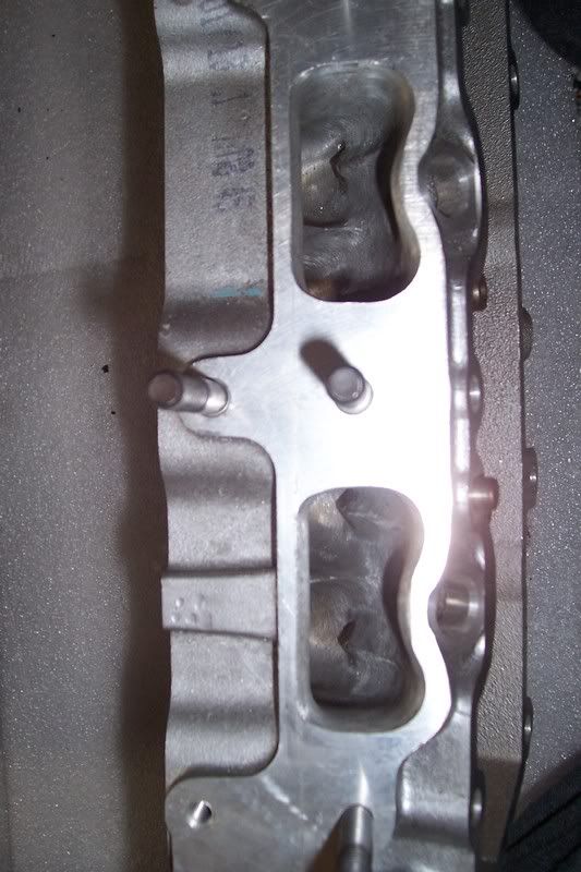

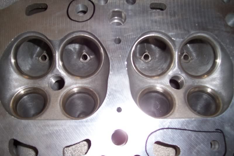

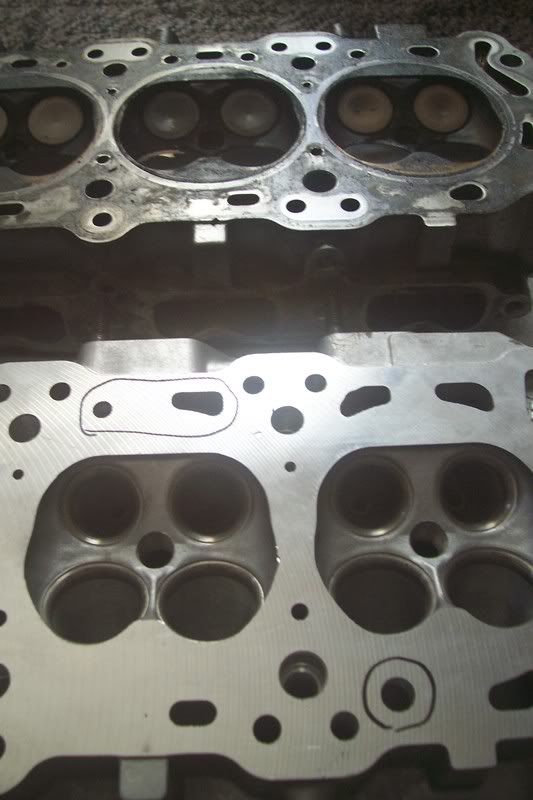

alright guys i just bought a new ported head I have a 96-99 block.
The head i bought is a brand new 00-02 ported head i was just comparing.
I knew there where a few differences when i bought it so.
Here are a few pics of the differences as far as i can tell its just water.
Do i just use a 00-02 head gasket or a 96-99 head gasket anything else i need to do to swap them over.
I also threw up some pics of the ports.
there are lil circles around the jackets on the new head that are differant.
Thanks,
Paul

I would use the 96-98 gasket and match the middle water jacket above cylinders 2, 3, and 4 to it. I highly doubt your block has provisions for the different shaped passages of the 99-02. You might even be able to get away with just using the 96-98 head gasket and not bothering with making the three new passages at all.

best i can say is get both head gaskets and do a comparison

From what I remember you can use a 00+ head on a pre 00 car, but can't use a pre 00 head on a 00+ block (without port matching). As for which head gasket I would say stiock with the one for the block you are using, but I could be wrong.

I would think go with a 00+ just because the new passages that are on the 00 head would have gasket underneath them if you ran a pre 00.

I'd say use your 96-99 gasket.
SInce that gasket will line up with the provisions on the block.
So you figure, whatever goes on top of that, will work itself out.
Where as, if you ise the 00+ gasket.
Yes it will match the head,
But its the block ports that are looking for the hole alignments.
So if stuff gets blocked off on the block, it could be an issue.
That's my thinking on it.

My 086 allows far more water to meet the gasket than the 00+ LD9 head will. It's been a year and still running strong.
The only issue with this is even cooling, which I really don't think will be that big of a deal anyways. I would just use the 96-98 HG. If you don't bother with modifying the head, then either gasket will end up doing the exact same thing. Using the 96-98, you have the correct holes to line up with your block and with the 99-02 you have the correct holes to line up with the head. The water has to follow the path of the water jackets that are matched between the block and head.
I'll give you an example of what I mean...
Imagine the yellow region is the head water jacket in the head, the red is the passage in the block, and the orange region is where they overlap. If you have a gasket to match the yellow hole, then it will only flow through the orange region. If you had a gasket to match the red hole, then the water would still only fill the orange region.
So, like I said, it really doesn't matter unless you decide to modify the head to match the block, then for sure you would want the 96-98 head gasket.

id use/make the holes larger to fit either , meaning opening the block and the head
to me alittle extra flow through the head = little better cooling
the extra small holes at the rear of the new head , id drill those into the block at the minimum

I would agree with a little, but keep in mind that opening the holes too much will greatly affect evenly cooling the cylinders and head as less water will reach the front of the engine. It's something that should be taken into consideration when doing the 086 swap.
